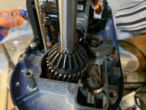

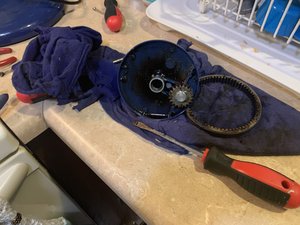

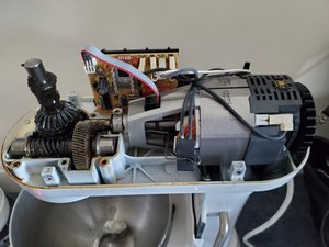

Here's some pictures the job that I did on it. Was white, I took everything apart, And painted red. I try to put a pin under the planetary but didn't work, Wasn't much space to hit the shaft and be secure. So what I did, I put the pin on the top side. I did use a pain that I bought on Harbor Freight Tool if you decided to make the same job make sure you open up the both ands off the PIN, it will prevent the pin to come off good luck.
After cleaning the housing and shaft squeaky clean, I applied two part epoxy to the splines on the shaft and installed into housing. I let the epoxy completely cure before drilling my 1/8” hole then installing the 1/8” spring pin. In my photo you can see the epoxy squeezed out about a 1/16". This prevented the upper ring gear from fully seating where I could not install the pin through the shaft. I used a razor knife to cut the epoxy off flush and everything fit perfectly!

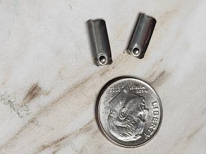

On a possibly related note, does anyone recognize these 2 small metal pieces? After doing the planetary head repair I decided to adjust the bowl-lift height (Pro 600), and at some point I noticed these lying on the counter top. Nobody in the household admits to placing them there. So I'm assuming they fell off the mixer at some point, but no idea...

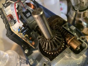

Update, I removed the planetary assembly again, and heated the shaft/socket area with a heat gun (it went up to about 280F). Then rested the assembly upside down on a block of wood and gave the shaft a few whacks with my brass hammer. This drove the shaft further into the socket, and greatly reduced the gap between the upper edge of the planetary and the mixer head housing. So I'm going to consider it repaired until the thing begins to fall apart again (hope it doesn't).

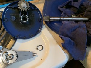

This just happened to me, and I hadn't initially realized that it was the separation of the splined shaft from the head piece. Confused I was when I tore down the unit to replace both the pin and the lock ring in the upper shaft which weren't broken in the first place, but of course after I removed them, the unit fell out just like it appeared to do during operation. Once I re-assembled and it still occurred that is when I decided to pull the separating part completely off and saw the spline, and then inferred that since it only went back in one way, that it was stripped enough to loosen. I sold off all my shop equipment, so I think I am just going to buy a replacement part. Cheaper than a new mixer. I use my mixer every day, with attachments, so I feel like that unless I could drill it out and insert a pin or set screw, it's only a matter of time before something like increasing the friction tightness would fail again, because bread dough. That is probably what loosened it in the first place.
