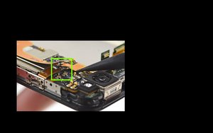

After replacing battery in amazon fire phone, I was unable to connect to wifi weak signal. it pick up signal only within 1 foot from router range. And also not full signal..
any suggestion what I did wrong during battery replacement process.
This is just a guess after looking at the tear down on Ifixit. I would be looking at the flat antenna connections and making sure they didn't come loose. It looks like you could easily catch the antenna cable with the adhesive strip you pull out from under the battery.

I check all the strips also antenna cable which is perfect, not loose but facing same problem very weak signal of wifi and Bluetooth this all due to replacing my fire phone battery.

Hi,
Here is an image showing the actual connectors. Check that they are both OK.
(Click on image to enlarge for better viewing)

Hi, It may be both as it mentions cables (more than one)
I checked it all the way.. black strip and golden strip are tightly inserted...
again tighten the black trip...but no success. wifi signal bar some time flicker..and jump to full signal but all sudden drop.
