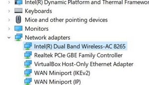

What is the status of the WiFi adapter in Device Manager?
Here's a link to the latest Asus Win 10 drivers. Scroll to find the WiFi drivers appropriate to your adapter and try installing them to check it it makes a difference.
Hi @jayeff
This is the status.
https://postimg.cc/image/6l670k70t/
I´ve went on Asus website
https://www.asus.com/Laptops/ASUS-Laptop...
And searched the drivers for my laptop. Found them via PC, downloaded them on external disk, transferred them on laptop and tried to install them but most of them cannot complete the installation because lack of the internet connection. Lol. :) I will try some from your link. Btw thx. for that link and for the reply. ;)
Hi @ Zlatko Mozetic,
It's strange that your Ethernet adapter isn't showing either.
You may have to do a reset on your laptop to reinstall Win 10 Pro as it may have messed it up.
You'll lose all your installed apps but not your data.

Hi. Plug your laptop in whit an ethernet cable, than go on devices, find your wifi adapter, and check for driver updates. Had the same problem myself (other type of laptop) turned out it was an realy old driver
Go into this pc》at top computer in between file nd view》manage》device manager》>Network adapter
》u can find something with wireless network adapter
》rightclick
》disbale
》wait for 5 sec
》again right click on same driver
》enable driver
》later u can try right click update your divers all drivers u can

you need to remove the wireless driver and reinstall the UPDATED driver from “DEVICE MANAGER”. go to asus site and get win10 32/64 bits that your lappy is either operating 32/64 bits
mine is ASUS ROG GL703GE
better to check Wireless Adapter Driver on Device Manager.
If it has a “!” sign.
as to my laptop it has that.
i just simply download update on Intel website on Updated Wireless Adapter Driver.
https://downloadcenter.intel.com/product...
After i downloaded i directly install it
you can search product updates here
for intel Drivers click here https://downloadcenter.intel.com/
and “WALLA”!
FIXED.

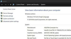

Wifi option not showing : Fixed it now >>
->First right click on this pc
->go to properties
->click device manager
->click on the network adapter
-> select the network adapter
->select driver
->click disabled
->And then enable
->select ok
