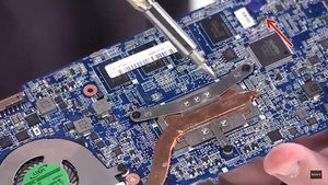

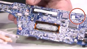

My system clock keeps on delaying compared to the actual time.
Is there a repair?
I also noticed that it may be caused by the CMOS battery starting to fail.
I have opened the device up and am comfortable, as I replaced the mSATA myself.
However, I don't really know where the CMOS is.
Where is it? Thanks

akihiko1639 post some clear images of your complete board (may take multiple shots) and post those with your question.
the connector is for your speakers.
The blue bit that can be seen is probably the RTC battery.
The images were taken from the Vaio Tap 11 teardown by Sony on Youtube.
Hope it helps!
