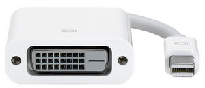

For the 20-inch or 23-inch Cinema Display:
You need the Apple Mini DisplayPort to DVI Adapter pictured here (or a third-party equivalent).
For the 30-inch Cinema Display
You need the Apple Mini DisplayPort to Dual-Link DVI Adapter shown below. (There is no third-party equivalent as far as I’m aware.)
Apple no longer sells either of these adapters, but they can be found on sites like eBay and Amazon.
