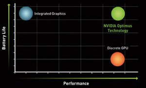

Hello, your notebook has two video cards - one is integrated in CPU itself and second is discrete - NVIDIA GeForce GT 940M. Technology which is trying to find the best compromise between battery life and performance is called NVIDIA Optimus - http://www.geforce.com/hardware/technolo....
When less critical or less demanding applications are run, the discrete GPU is powered off and the Intel IGP handles both rendering and display calls to conserve power and provide the highest possible battery life.

SLI and Crossfire are little bit different story - we can use this technology if we have two (or more) similar video cards and use parallel processing to increase the processing power available for graphics. All graphics cards are given an equal workload to render, but the final output of each card is sent to the master card. https://en.wikipedia.org/wiki/Scalable_L...
The question is related to NVIDIA Optimus technology which is focused to optimal performance/battery life ratio.
