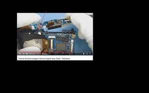

Hi Seyed Farshad Zolfaghari,
Here is a video showing how to dis-assemble a Sony W630.
The video is in Portuguese, hopefully it will still be of some help to you.
At 5:54 minutes into the video the battery is clearly visible (at least I think that it is the battery). If it is a battery the type information should be printed on it.
(click on image to enlarge for better viewing)
Hopefully this is of some help

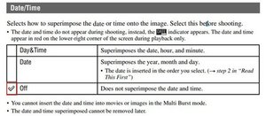

Hi @josephlittleton,
When you click on OFF does the check mark next to the word OFF disappear?
If so, the word may not change to ON, it just means that the function is no longer OFF i.e. it is now On and it probably means that the date and time will be superimposed on the image.
Does the Date icon come on if the check mark is not present when you try taking images etc?
Here’s an image of what I mean. Check mark is highlighted in red box
Many thanks for your help. Date/Time is at "Off" and I've tried to change to "On" but without success as it stays at "Off". This is probably why the date does not superimpose on the images that I take.
Many thanks
Joe
Hi,
Does the check mark disappear when you click on OFF or not?
If it does then take a picture and see if the date and time is there.
I suspect that the word "ON" will NOT appear it will simply show either that "Off" is selected or not selected.
If "Off" is not selected it means that is is "ON"
