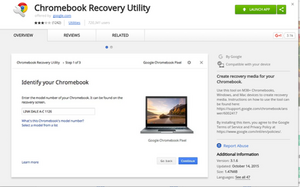

If you can create the recovery media for this device with the Chromebook Recovery Utility and another chromebook or PC that supports USB devices or SD card media that is compatible with your target chromebook you should be able to reflash the device back to factory image after cycling it into developer mode and then back to standard mode. Here is what the utility for the chrome browser looks like in the chrome web store...

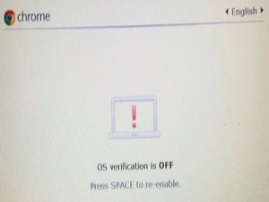

Developer mode startup screen...

i actually tried to use recovery media it didn't work. I am stuck on the hardware part i removed the screws but now i don't4 know what to do. do i remove anything else
i need to get to dev mode first
after that i know what im doing
https://lifehacker.com/how-to-install-li... have you tried that ? incidently the refresh key should have a circular arrow logo on it mine is on the F3 key.
If those instructions don't get you into developer mode then perhaps google did something insidious in this management mode that blocks that hot key startup sequence from opening the door to the developer mode enabling. If so I can't tell you where to go from there. I've never actually seen one in managed mode and read very little about it either sorry!
