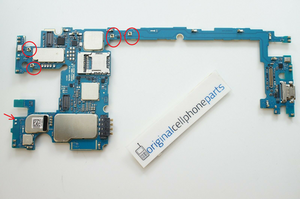

All connectors are only connected to that point on the upper bumper .. I connected it with an antenna inserted in the bumper, but the signal only increased by one bar. I think the problem is upstream of the antennas .... The reception really sucks!
this is ipg of motherboard
Here’s an image
Not entirely wrong those are test points for when the phone was made. They do connect to the antenna circuits... There are 2 gold points to the upper left most circle those connect to the sticker that runs out the top bumper of the phone and serves as one of the antenna if you swap screens and frames you need to gingerly peel it off and put on new frame as it does not come preinstalled. You need to peel about 10 things off I would say the proximity sensor was the 2nd worse next to the antenna.

It is a sticker right above the earpiece connected with 2 gold points. It boggles my mind how much of this phone relies on gold pads on little stickers for sensors and such.
