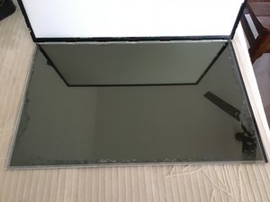

Hello guys,
I just encountered something weird on my laptop. FUNGUS!!!!! It must be them as you can see in the picture. Yesterday it was only just a very tiny dot on the screen. After one day, it got this big.
Is there anyway that I can clean it myself? Appreciate if anyone can help me :)

Here's the picture of the most up-to-date condition :(

I tried to dissemble the glass but I failed. It was too brittle that it started to shatter as soon as I pulled the glass up. I am ordering a new front glass now and it will be arriving in 1-2 weeks time. I will update you guys as soon as I receive it.
Update 3 (28/12):

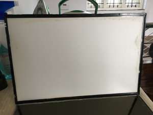

My friends and I managed to disassemble the glass and we all hoped that it was on the glass but no :( it's still there, inside the LCD screen I guess? We did use IPA to clean the screen but no effect. I think I will have to order another LCD screen for replacement. This is how it looks like now, really bad right? I guess the mold has won this fight lolol
For this one, I didn't notice it at first. Now, I'm wondering if it is the mold or the screen malfunction itself.

Sadly, no John. I had to replace the whole LCD thing. I think it was within the LCD itself.

See update. I'd look for other areas and use at least 90% alcohol to disinfect it.
Living stuff = bleach to kill it. I have no idea what that would do to your screen but I would assume 1:10 bleach to hot water wouldn't hurt anything and it should be potent enough to kill the little spores.
I won't lie...this is kind of awesome. I've never seen anything like that before.
Biggest issue I see with that, is that it is between the glass and the diffuser. The panel will have to be totally disassembled. Mark the diffuser sheets when you do so. There are a few different ones. It is pretty cool looking. Unusual so since fungus thrives in warm, dark, moist spaces which is not necessarily in front off a bunch of LED's
