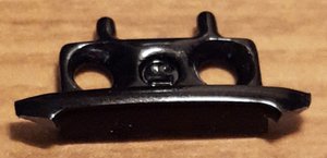

Here's What's broken for me :( Can you please check it and direct me
the same thing happened to me. you can go on ebay and look up beats solo 2 wireless hinge and buy that. then look up a teardown video and follow those steps. it looks really difficult but its really easy.
Same here man where the L is
Replace hinge or have hinge replaced. Difficult to do on your own without experience.
Hinge replacement is almost impossible. The smallest part of the wire harness has to be fed through the new hinge. This means you'll have to cut and re-solder/couple about 15 tiny wires, which is basically a no go.

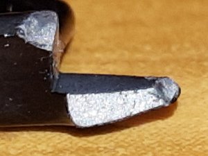

I had the same issue, and opened the panels to see how I can replace the hinge and found this fact.
Conclusion: If the hinge metal is broken, the beats are un-repairable IMO.
