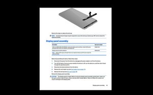

According to the service manual for your tablet, the touchscreen and LCD screen are all one assembly and have to be replaced as a module.
Here is a link to the service manual. Scroll to p.19 to see screen removal procedure

Here is an image taken from p.19 of the service manual. It shows the part numbers for the necessary parts.
Take notice of the Note: information on the page.
(Click on image to enlarge for better viewing).

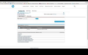

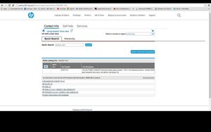

Searching for the parts online using the part numbers produces no results, however the parts are listed on the HP Partsurfer website, so perhaps you may have to contact them regarding the parts availability.
See images
(Click on images to enlarge for better viewing).
