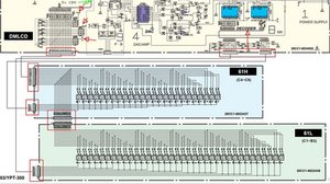

"E" key and 3rd black key is not working.
my Yamaha has 2 keys that are not working in every octave they are out. they are the "E" key and the 3rd. black key.. all the way across the board. Can someone tell me what's wrong?

Here is an image of the relevant part of the circuit which affects the E key. I think, not being a musician, that it also affects the "3rd" black key as well as they share the exact same wiring path up to the keys.
They are both 'powered' by the same 3.3V DC supply rail fed from 10K Resistor(s) R838 pins 5 and 7. This power feeds into the MicroProcessor (CPU) and also through the keyboard and back into the decoder.
The circuit path through to the keyboard is the most likely area of the problem as it passes through two connectors to get to the keyboard.
You need to check that the 3.3V DC is available at pins 5 & 7 of Resistor 838 on the DMLCD board and that the appropriate wires on the CN831 connector and CN1 connector are not loose and that the connectors are inserted properly, especially as the wires are at one end of the connectors so it might not be inserted 'straight'.
The circuit that you should test is from the DMLCD board Resistor 838 resistors pins 5 & 7 to connector CN831 wires 11&12 which go to 61H Board (on the keyboard itself) connector CN1 wires N24 & N14. From there it is multipled through all the E keys and 3rd black keys and then out to the decoder. The wiring to the decoder is 'shared' by the other notes so it is alright as they are working.
Click on the image to enlarge for better viewing. Look on left of diagram, to the right of label DMLCD to find the R838 resistor stack then follow down through the connector to the connector directly below.

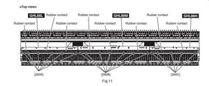

Can you help me with the same problem but on yamaha PSR-210?
Hi @hall_pass_please,

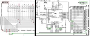

Here are some images taken from the service manual for the keyboard which may help to find the problem. The manual shows how to dis-assemble the keyboard so that access to the boards, connectors etc, is possible. Be patient if you go to download the manual as it takes a little while to go from processing to download, once you have passed the recaptcha test and clicked on go to download, below the document preview box.
The C and the F# notes share the same two wires through the keyboard keys and back to the DM processor board.
See the composite image below that shows the two wires where they leave the keys on the GHL88M board Connector 2 wires n16 and n26 to go to DM board Connector 6 wires n16 and n26 to get the power and also to connect to the CPU.
The n16 power feed is via resistor R102 and the n26 power feed is via R129 on the DM board.
You need to check that the +50V is on both resistors and that the connectors are plugged in securely and that the wires are terminated OK on the connector etc.
I have only shown the relevant sections of the circuit for the keys (notes? - I’m not musical at all) and also where the GHL88M is in relation to the other sections, but since the power leaves the DM board and then gets to the GHL88M board 1st before it multiples to the other boards/keys and as all the C and F# notes are affected these are the most likely trouble spots.
Hopefully a start.
(click on images to enlarge for better viewing)
