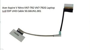

Sorry Dmitri, one more comment here (question) is the uhd (or fhd as case may be) cables are not long enough to route through the hinges into the motherboard (see picture for uhd cable although for vn7-792g) By motherboard do you mean video board (not talking of Nvidia board but the graphics processing area) that is in the lcd cover? Thanks (guess that is what I am confused about-also) thanks and sorry for multiple messages.

regarding your cable - google which cable 4k model should use and buy the exact cable which fits your model.

Just saw your message now. About an hour back I got it to work...duh...I had not attached the connector to the screen properly. Don't know how many times I connected reconnected both ends. Used the cable for the VN7 792G (bend is opposite but it fits and long enough-canceling my order for the 793G specific cable as very hard to find and backordered in Europe)...discovered a Youtube video where maybe the only instance where the video creator focuses on the connection part to the panel (he has an Aspire 5 or some other model) and says it is a common mistake. Found that video when I discovered the FHD also was not working (wondering if cable or panel or something else) Without BIOS screen too as it will not show up on external monitor (but then read battery disconnect resets BIOS-not sure) But it works now. Except battery again is not working even with reset. Might try a BIOS reset once all buttoned up. In the end, smoother than expected but took a long time because am not good with these fine attachments.

Your current FullHD cable is 40 pin (motherboard side) => 30 pin (display side)
You need a 40=>40 one, part number is 50.Q04N5.015 - you can get that from amazon, ebay or... I've just ordered mine in the nearest laptops repairing workshop.
