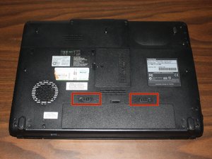

How can I remove the battery? I think the battery is dead all the time even after charging it overnight.
Is There Any Way To Post A Picture Of Your Laptop - Preferably The Bottom.
Normally Laptop Batteries Have Slide Locks That Hold Them In. Take A Look At The Bottom Of Your Laptop.
Please Note Image Is Not The Same Model As Yours - For Part Identification Purpose Of Battery Removal Tabs
There Should Be Sliders Like The Ones Shown In The Picture.
Once You Slide Those To The Unlocked Position The Battery Should Come Out After.
Upon Getting An Actual Picture Of Your Laptop. I Can Further Assist You

To add to Carl's good answer, here is a link to the user guide for the laptop which shows how to remove the main battery.
https://www.manualslib.com/manual/203306...
The battery is the long rectangular outline on the underside of the laptop towards the screen hinges. There are two pill shaped switches close to the battery that have labels 1 and 2. For switch 1, slide it to the unlock position (specified in the small diagram next to the number). Next, slide switch 2 into the unlock position (also specified by the small diagram next to the number) and hold it in that position (it is spring loaded so the switch will return to the lock position upon release). While both switches are in the unlocked position, use your fingers or a thin, sturdy object to lift the battery out from underneath the indent between the two switches.
