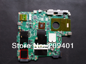

Title says M51S, but maybe it's closer than alibaba's pic below. Maybe it needs only removing the bottom cover, I'll try...
From what I could see in the youtube clip the battery should be under the black plastic where I marked it with red in the picture above. That's why I think you would have to remove the whole back-cover, the hatch will not be enough. For me it looks like a lot of work to change the battery, but I think it is the same on my Asus laptop from 2015.
I looked at two disassembly videos last night one from a M51S and the other from a M51T and there the battery was at the same spot, so I think it should be on this spot here to.

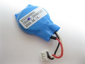

here a cmos battery image , i think you have to remove the back panel or more
i dont have found any service manual or instruction . It is a CR2032 Battery
hope this helps

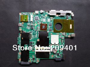

I think that's not the right one...
Weird,
my mb looks just like this:
, BUT there's no battery where it is in that pic.
2 photos from cpu downwards of that alibaba's pic:
(ODD connector is white in my mb, black in alibaba's)
Those 2 metallic poles might be holding something on the backside. Maybe the battery is flipped there?
