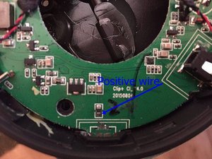

I dont have how to charge my Speaker, my micro usb is detached and in service all says the same: It cant be repaired. Can i charge my battery with other method? I want to cut battery wires and add usb port to charge it with phone charger.

@norbi does the second last image show where the connector used to be? Your English is fine, probably better than our Polish:-)
The last image shows where the micro usb was, this little lines on bottom. The second last shows 3 Wires, Red, Black and blue, Getting out from battery, and the Black that is at left shows Mini Jack. I dont know nothing about electricity, i know only get together wires, to solder it.
if you can post me this picture or something, i can do new more precisy to show all of the components.
@norbi yep got it now. Is there any chance you can zoom in with your camera? when I enlarge the picture it becomes to unclear. It looks like there are traces that are visible....

@norbi not a good idea just connecting it to the battery. You are bypassing the whole charging circuitry which controls rate of charge/ over charging etc. I would connect it to where the old port is. Post some imgaes that show the whole PCB and the micro USB port.

I'd connect the positive to where the positive from your connector was.

@norbi sorry but was busy last couple of days and only briefly paid ifixit a visit. I attached an image where I would connect the positive wire to. The negative should be okay to connect to the battery wire.
Could you send me image when to connect the second wire? i will be very happy :) because battery has 3 wires.
Thank you SO MUCH You are the best Bro! I found the negative it was black. SPeaker is charging Thank you again!
