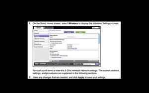

Have you been on this screen in your router's setup area and scrolled down and found Wireless Network (5.0GHz a/n) and enabled SSID broadcast?

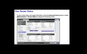

If so have you been on this screen to see if it is enabled
If it hasn't been enabled do so and then see if the light comes on and that it can be detected by an appropriately equipped PC, i.e. it has 5GHz WiFi capability.

The photos showed up too small to see what they were and I couldn't enlarge them enough either but
figuring they must be some kind of Genie screens, I used the genie program thats installed and went to
the support paged where I found some info that jibed with what you had written. It also gave me the same url you had mentioned so I went there and was able to get the wireless channels working good. Thanks again for your help. Ray.

Bit surprised that you had a problem with the images I posted. Usually if you click (or double click) on them they open up to a reasonable viewing size in a new window.
