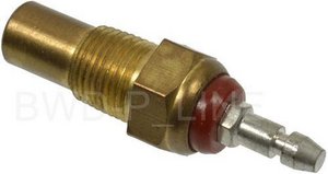

This is the new sensor:
Wondering what else can check for, seems this coolant temp sensor is at the end of the line of things. There is nothing else feeding into that dash gauge right?
@xyzabc if the sensor is not the problem the the gauge is your next likely culprit . if however the sensor has a ground wire check the ground first as a faulty ground can cause this but since the sensor is metal by the picture its probably self grounding
Hi @xyzabc ,
If the gauge stays at zero with the lead disconnected then check the new sensor with an Ohmmeter.
The resistance of the sensor between the body of the sensor and the sensor connector tag should be ~140 Ohm when cold. (you can do this out of the engine)
If it reads ~30-50 Ohms or even s/c (short circuit) when cold then the sensor is faulty.
You can also check that there is no visible connection between the brass body of the sensor and its' silver connector tag, due to a manufacturing defect From your picture there is an insulator (brown ring) there. Use a magnifying glass if you want to. A small shard of metal is all that it takes ;-)
If the readings aren't 140 Ohms or s/c or 30-50 Ohms when cold, check that you have the correct part.
It looks like the reading is .57 for the new sensor while still installed, which I think would not affect the reading. I'll take it out tomorrow for up close examination for burs. Also perhaps I am reading the meter incorrectly, this is when I set it to 2k, when I set it to 20k it still the same. So this .57 means that it is roughly half an ohm? Or does the .57 mean 57ohms or 570 ohms because the range is set to 2k, I've been trying to google how to read the ohm meters, but I don't get why it's not 1k 10k instead of 2k 20k and whether the number on the screen is still ohms or some ratio of the current setting. When I set the meter to be just 200, then it just reads 1 when connecting the leads to the sensor, my guess is the meter is not sensitive enough at that setting.
When I test the old part, it reads .610 when the ohm meter is set at 2k and 0.61 when set to 20k so I believe this means I should read it at less than one ohm.
Perhaps I got a bogus part. I'll bring my ohm meter to napa tomorrow too.
