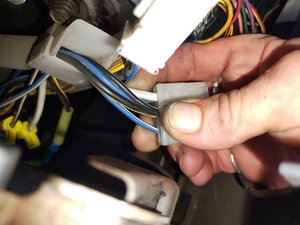

You definitely have 3B- Yellow, 2B- White and 2L-Black. If you post some images of what you are looking at, we might narrow it down. Use this guide for that.
this is the harness I just need to know which one is the battery wires and which one is the ignition wires
@bonnie88229 looks like Black/Yellow and Black/White for the ignition. White should be battery but we need to know the exact year, model and engine size to make sure. Use a test light or meter on each wire. You should be able to get the battery + which should have power at all times.
