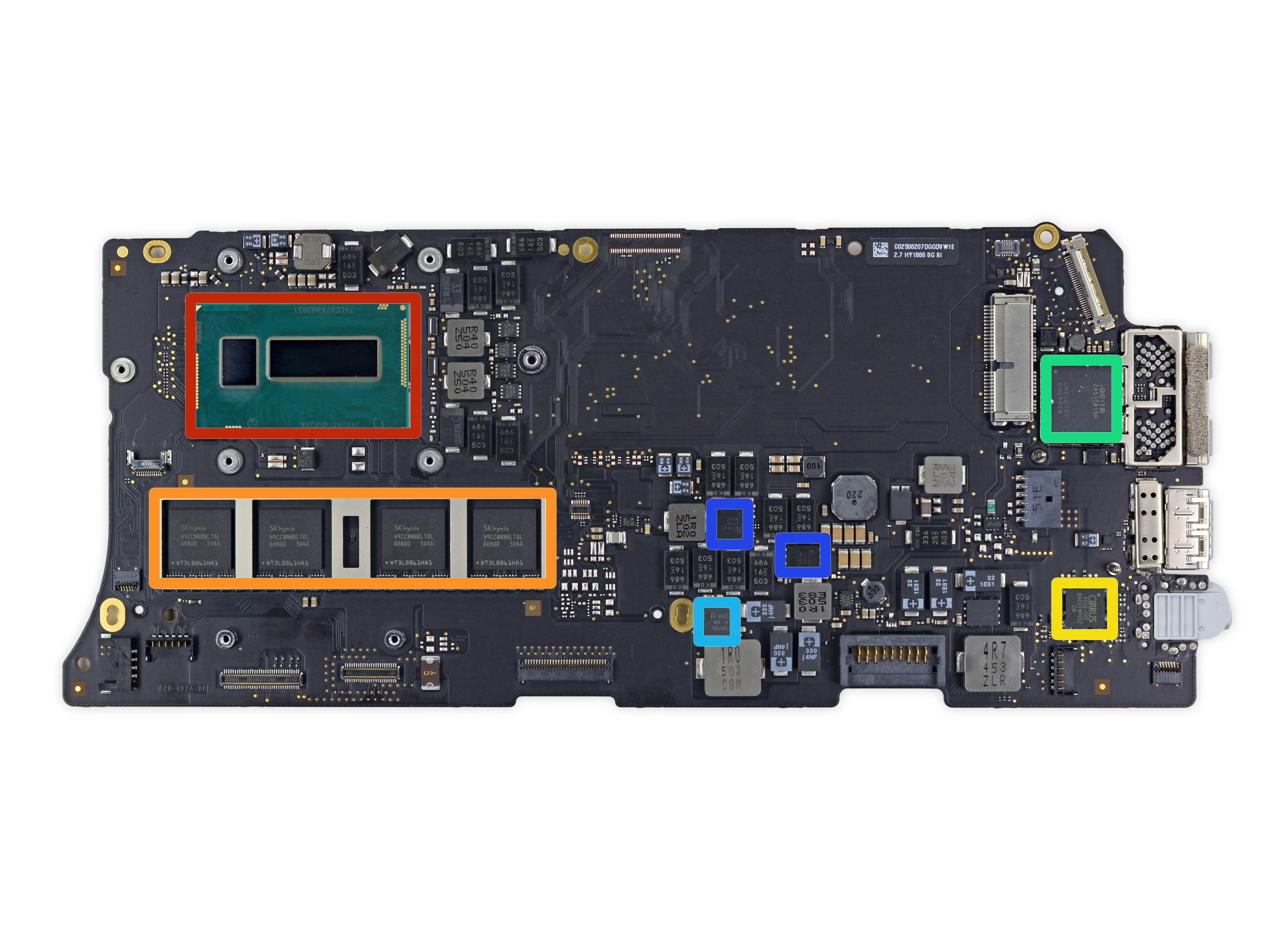

It does look like someone was a bit rough on the connector. Here's an image of the main logic board which you can compare yours to: 13" MacBook Pro Retina (Early 2015) Logic Board.
At this point I think your issue is more likely the cable that goes to your trackpad or the trackpad logic where the signals for both the keyboard and trackpad come together.

If you strongly believe the issue is the connector on the logic board then you'll need to send your system to someone who can do the needed micro-soldering and has access to the part. Otherwise you'll need to replace the logic board.
I think I would first try the cable it's a lot cheaper!
You're right, I'll try to find somewhere selling those and test a new cable, hopefully that will fix it. I'll comment the result here. thanks for your help though
I tried a new trackpad cable and it worked!! Everything is working perfectly!
