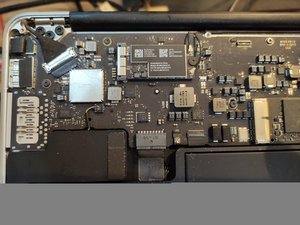

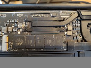

@danj Hi Dan, I tried to edit my previous post to include pics as requested but it got deleted by the robot as spam, not really sure why. So trying again..
Spilt water Mac..turns on but faced with a black screen. Flashlight trick works and when I try an external display only, it shows a cursor on black screen. Logic board shows some rust? which I tried to clean with isopropyl but without avail. Couldn't spot any other signs of visible damage. Any thoughts would be appreciated.
Pics included this time:
Thanks, Hannah
So the fact the external display is showing a pointer we know the systems graphics is working but the CPU logic appears to have failed ;-{
You'll need to pop off the heat sink to clean under it as thats where your damage is likely. Also the JTAG port doesn't look good thats the connector near the Airport along the edge. A short with it could also mess you up.
Thanks Dan @danj , I haven't gone as far as taking it all apart but can remove the heat sink. If I clean it, do I need to reapply some thermal paste before putting it back?
I will read into the JTAG port a little more based on what you have said as this is all new to me! Thanks.
