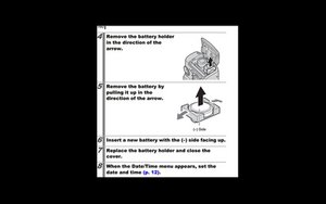

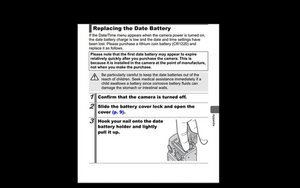

Also camera requests that I reset the date & time every time I turn on the camera.
Hi,
First regarding the date and time. You need to replace the date and time battery in the camera. Here are some images on how to do it.

The new battery corrected the date/time issue. Thanks so very much!
