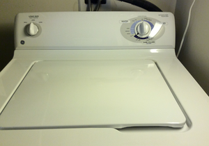

My dad is looking for a part for his GE washing machine and his repairman told him he couldn't get the part since the model number and serial number are missing from the machine. I find this hard to believe. Does anyone know another way of finding the model number/serial number?

Do you have a picture of the washing machine? Do you know when it was purchased?

@molloy3 open the lid and check for any tag. Same with the back. Post some images of any tag with your question. You'll have to edit your question to add the images. They will not show up if you post them as comments. Again, any tag may help.

I have a machine that looke just like it the Model WDSR 2080 DBWW. .
For top loader-the model/serial number may be found in the following places:
1 under lid, near the right hinge
2 exterior,on the back of the control panel
3 exterior front,bottom left corner
4 exterior back, near the water inlets
Inside the back of the machine there should be a wiring diagram. Check that. OR Get the part number from the timer, (Paper tag on timer) cross reference that.
