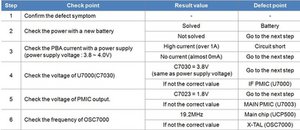

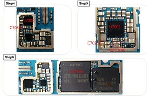

Warnaka Gunawardena I'd start off by following the steps from the service manual for the no power option. Since there are a few different versions of the circuit board it will help if you post some good images of yours. That way we can find the components you need to measure. To post images use this guide
