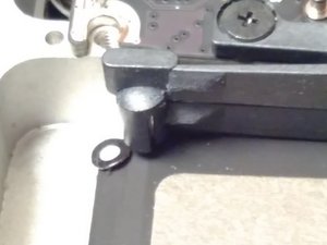

So I took it apart again, and what did i find... apparently, as i said, and for everyones happines it migh not be the soldering at all!!
It seem the CLIPS that hold the stick closest to the keyboard are worn and do not have enough pressure so they do not hold the ram in place all the time, a little bump and the RAM stick springs up like half a milimeter and the problem appears.
What did i do? Got a 1.5mm (.60 cal) piece of flat styrene about 3mm wide and 7 or 8 mm tall, put BOTH RAM sticks in place and with a little plastic tip/spudger push down the stick closest to the keyboard so the clip can make its full travel inward and insert the styrene pieces one in each side in the slots between the clip and where the screws for the bracket are and then push them towards the RAM contacts to make pressure inward so the clips are pressed firmly against the sticks (you wont be able to remove the sticks without removing this styrene pieces).
I did this, the MBP started with no problems, i can now shake it and won't freeze and/or beep at all.
I'll try to make a video or at least a photo guide showing what i mean and post the link (it will be my first YT video so be nice hahaha) so it shows the fault and fix clearly.

As shown in the red circle in santiagogdelatorre's photo (above), there is a narrow air gap between the the clips which secure the RAM cards in their slots, and the logic board which surrounds the RAM cards. Purpose of the fix is to fill this gap, thus securing the clips in place.
I used strips of old credit cards as "filler" to insert into the gaps. I layered 2 old credit cards of different thicknesses to fit into the gap. The correct "snugness of fit" is that the strips don't fall out by gravity if you flip over the machine, but you can easily pull them out with a tweezer. To make fillers of the correct size, I cut the credit cards into ~1" x .25" strips that fit into the gaps and, with both RAM cards in place, I inserted the strips into the gaps. Then I marked the correct "depth" of the strips with a sharpie, and trimmed the top off leaving 1/16" protruding, to remove them with a tweezer if needed. This fits inside the cover of the machine, no problem.
THIS FIXES THE PROBLEM. I used hard plastic instead of styrofoam. I had this problem whenever I moved my laptop from my car to work and back home, I would get the 3 beeps. That showed me that it was a physical issue. That led me to believe that holding the ram in would solve it, and it did. Since doing this fix I have not had the issue, not even once. It has been 2 months now.
I cut sections out of a thick zip tie. Then inserted one on each side of the ram holders, pretty much where this person put the styrofoam.

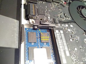

I was so happy to read Santiagodelatorre's analysis. *That* finally made sense to me. And his solution seems to work for me too.
At the end of the RAM clips, there are little round protrusions that fit in a round opening in the side of the RAM stick. But those are not actually what holds the RAM sticks in place. You need to look even more closely for small plastic 'wings' that extend from those round protrusions.
Photos in a public Google photos album.
(Note on the photos: there are two photos that are almost similar. Except in one, the RAM stick is being held down below the plastic wing, whereas in the other, that's not quite the case. Hard to see, but very real)
Those wings (same material, same color as the rest of the clips) are meant to be flat at the bottom. So that the RAM stick rests against them: flat surface to flat surface.
As you can see in the photos, these wings have become degraded: they're not smooth like the rest of the plastic parts of the RAM clips. It almost looks like the plastic is just falling apart by itself. It doesn't look like wear and tear. Perhaps the sticks get too hot for the plastic.
In my case the protrusion on one side was no longer perfectly flat at the bottom. This was the wing for the bottom RAM stick. Since the RAM sticks are actively pushed upwards and the wing wasn't quite on top of the RAM stick, the stick would gradually push the clip aside, and thus the stick would move upward just a little.
Presumably that causes the memory problem.
This is why shocks (like the laptop receives when I put my bag down) would cause the problem to start. And why the problems gradually got worse. And why there are moments, near the end of that cycle, where the laptop will work fine while flat on a surface, but will crash as soon as I gently tilt it away from me.

Hi everyone, I have the same mid 2012 macbook 13” with both RAM memories mentioned above and with the same problems. I have done each and every possible tips mentioned by all with same results, it works fine and then fails and starts with three beeps.
Worthless to say it works beautifully with only one RAM at the top slot. I fixed a big problem that caused it to restart when you picked the laptop with the left hand by inserting one or two credit cards below the RAM slots and the bottom.
Finally with both RAMs installed I can use the mac normally for a long time without any problem, but when I let it sleep some times it would turn off by itself and when trying to turn it on again the three beeps will appear or the strips then I keep the start pressed to turn it off and again I try to start it and it would normally.
Bottom line, I can live with this problem or buy an 8gb RAM at the top slot to compensate for the speed.
@psims Im going to try this. Sometimes, my mid-2012 13” MBP turns on but man, I better not even look at that thing or move it ever slightly or press hard on the touchpad or keyboard because it will freeze, turn off, and do the three beeps when I try turning it on. I just took it apart yesterday but minimally and did some cleaning and stuff and put it back. It turned in and was working but when I pulled out this USB stick, it turned off and I get three beeps again.
To confirm, do these three beeps have anything to do with the disc reader on the left when flipped upside down or is it the RAM cards that people keep referring to here? I have a bone stock MBP.
3 beeps = bad RAM. CHANGE OUT THE RAM. Or just remove one or the other to see if you have bad RAM respectively.
I changed both 4gb RAMs with 2 new 8gb and this things is soooooo much faster. I think one of the RAMs was bad and I was only working with 4gb RAM. Thanks man!@iheartmacs
The method that worked for me:
