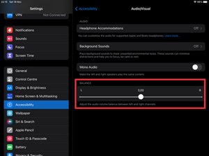

Go to Settings - Accessibility - Audio/Visual and check if Balance is right in the middle - I remember once it got messed up by itself for absolutely no reason, but I fixed it this way in seconds
Why should yoy do this....? when it is no sound in one of the speakers...?
whats the Point...?
Try it - you’ll see ;)
