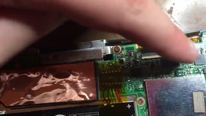

I also found this issue with a TF103C tablet. I opened the case and re-seated the screen pig-tails and the screen became fully responsive. Then some time later the screen was again unresponsive. I'd read that a static buildup on the screen can cause the screen to become unresponsive so I opened the back but this time just touched the screen pigtail connector rather than re-seating the connector. Again the screen regained its touch control. I think there's something to the static build-up theory and will use that fix in the future.
Is there a tutorial or something on how to open it? I'm not really comfortable with it, how hard is it for someone who has never opened a tablet or a phone?
Interesting​. Can you show the cable to play with? Is it easy to reach? Thanks
Are you think programs that you install it?My opinion is that if you download lot of programs that is not optimise your pad,then it can bad.
where the finger points
So should I just touch it?

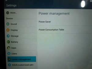

Connect keyboard via keyboard slot or via USB and turn off Power saver in Settings and touch will work again
