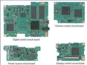

My canon recently had some of the buttons stop working I called canon they said that because i used a 3rd party software that it had diffrent voltage and messed up my circuit boards. Do you know if there is anyway fo fix this my self being that canon does not support repairs on it anymore.
@samuelg that absolutely does not sound right. The question here is which buttons did not work and which board did you think you needed to replace. The boards may not be available new (Canon would not have sold them to you anyway) but are available at online places. You just have to know which once you'd be looking for. If it is truly a power issues I'd be concentrating on the DC/DC board part number CG2-1689-000 000, or the LPU board part number CG2-1650-000 000. I attached the schematic for your camera just in case you have the tools and the skills to check the board components. Circuit-Diagrams.pdf and the major circuit boards for your camera look like this
sad to say i dont think there is a replacement circuit board available for this camera
I think canon lied to you, if you use third party software it wouldn't kill the buttons.
