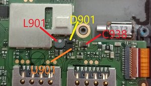

redmi 2 Prime display lighting is very low
The lighting is very low and it can be seen only when a flash light is used to. Looks like the phone touch is ok. I tried to replace with the new display, the same is remaining on testing it
There is problem in ic light. Find in PCB then change with new.
