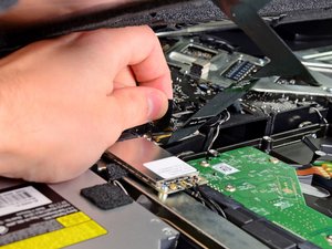

I recently took apart my iMac to replace my hard drive. After doing so my display wouldn't turn on but I could tell the Mac was working because I could hear the fans leading me to believe I had damaged the display connector.
After taking it off again I noticed I had broken it. So I went to Amazon and bought a new one for $26.
However I can't figure out how to place the connector in and I don't want to break it again. Please help

Hi, you can see how to plug it here
iMac Intel 21.5" EMC 2428 Display Replacement
Thanks, saved me some heartache!
The larger end of the connector is placed on the LCD panel board. The white numbers you see on the cable will face towards you when you're plugging the cable into the LCD panel (so they would face the back of the iMac housing when installed). Your replacement cable does not have these white markings, however, so I'd overlay it to see what direction it needs to be plugged in. If you're looking at the back side of the display, it should look like this (the same way you have it in the pictures, just with the backside of the display behind it):
The display side of the connecter has two release clips on either side. Gently pinch the connector from the two furthest points and slide it in without using much force.
When you're going to put the screen back on the iMac and plug the smaller end of the cable into the logic board, it is essential you get the display as close to the computer as possible (smallest gap to work with unfortunately....), make sure the retaining clip is on the top of the connector so it can be pushed down after the cable is in place to secure it, and insert the cable parallel to the board. I would prop the display open with another person's hands or, I personally use a small box on either side. This is so you can use two hands, because trust me, it is easier to use two hands to work on the cable than one to balance the display open and one to push it into place. Clip the retaining bracket, and screw the display in and test. As long as you don't break a socket off the logic board, you will likely be in the clear afterwards.
Hope this helps!

Hopefully not too late too comment…. That cable is a pain in the butt, i had the same issue. Broke the original cable and bought a new i tried on and the display was black removed the freaking thing 3 times. At the end i realized it wasnt seated on the monitor side ALL THE WAY. Take your time and make sure is in properly you will feel the small click when properly inserted.

if it moves, it's not properly seated. I think the easiest way to install this cable is to connect first the motherboard side, and then connect its end at the LCD.
