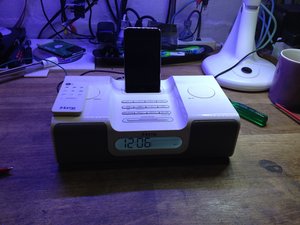

Daughters iH8 had same problem. No schematics available and not a viable repair job for economical reasons. However I found the fault and it is a manufacturing one that is likely to be the cause of many of such no display /operation failures. In my case power was there to the keyboard and charging the iPod.
Internal supply rails appeared OK, other than the secondary rails driven by the Toshiba TC9349A Microprocessor (a SMD device mounted just behind the display and covered by RF shield ) and you guessed it this also feeds the display. I found that if I placed my oscilloscope on the Micro Clock, it started to work, however would stop shortly after it was removed. When I removed the 75Khz Crystal
there was rubber glue that had gone hard and as is common, become conductive and detuned the crystal. Removing the gunk from across the leads fixed the problem.

Big thanx to George A who showed me how to add images
Pickies below showing the unit in question, There was also a break in the board PCB track and you will see where I have placed jumpers to fix the other fault. The RF shield is obvious, you will see the gunk on the PCB where the crystal sat and that caused the problem, the crystal is shown above and the micro that sits under the shield where you need to remove the crystal to clean it (Crystal has been desoldered and removed for cleaning in the picky)
Many Thanks - That was also the issue with our HiP99
