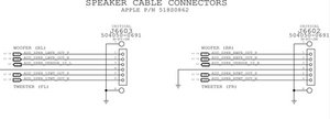

Few questions on the speakers:
1. What is the pin out for the four wires from each of the built-in speakers connecting to the logic board?
2. Where is the 17 watts amplifier powering the speakers, is it on the logic board or contained in the speaker units? In other words, can I hook up those speakers to an external source and have audio play through them at native volume levels?

here is the PINOUT for the Speaker Connectors on Logic board 820-2828
Update (06/21/2020)
here is picture
Update (06/21/2020)

iMac 4 pin connector Right Speaker
pin1- black wire -woofer +
pin2 -gray wire -woofer -
pin3- brown wire- tweeter +
pin4- gray wire - tweeter -
iMac 5 pin connector Left Speaker
pin1- black wire- woofer +
pin2-gray wire- woofer -
pin 3 no connection
pin 4 - brown wire- tweeter+
pin5- gray wire tweeter=

Searching for "K62 mlb" on google gives the iMac 27" main logic board's schematic diagrams. Finding any pinout from that is pretty straightforward.
