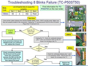

Mine is flashing 8 times.
Mine is flashing 8 times. Anyone has any ideia ? Thanks guys
@casanvi for the Viera series the 8 blinks is a Driver SOS 3 SS Board (SS energy recovery circuit) error. For further troubleshooting and getting you in the right direction, we'd need an exact model number. Start by checking something like this:
Yo tengo el mismo problema e led parpadea 8 veces modelo TH-42PD60X
