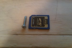

It looks like the case has four screw holes and all the screws are missing. Mine is a sears tele-games console, but I think it's an exact clone of the 4-switch atari 2600. I'd like to know the screw sizes for the case so I can put this thing back together properly!

Give me a second, I'll dig out mine and take a picture of the screw for you.
Here you go, it's about 3/4 Inches long. I put it next to an SD card for reference.
And all 4 are the same
