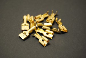

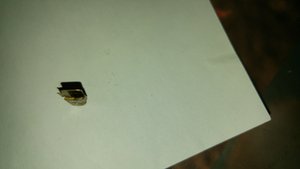

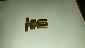

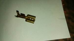

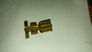

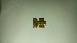

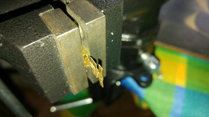

Hello guys. Maybe someone of you had problem with soldering 2of4 bms plates. So as you see i'm too had this problem and i solved it. I want to share my solution. So after few hours try soldering my wires i got idea. I took female connectors and i made some kind space which i can soldering and it will be
to conduct electricity. I it works. My battery again is charging 3.5 hours. I add pictures with my solution this problem. So about battery which i used it was 4xSONY US18650VTC5 2600mAh. At the pictures you will see about what i'm talking .
Update (05/02/2017)
So about how to make this connector.
First you must clean it in something (in my case it was alcohol).
And rest you have on my pictures, but you have to be carefull during grind this connector. It is realy gnetle. I destroyed 10 of this connectors before i make 2 proper. And to make proper shape of this connector i used thin screwdriver.
And about broken bms, you can avoid it but you have to buy battery like that (protected battery) http://www.bto.pl/produkt/43723/kp-icr18...
But then it will be bigger problem with put it in.And then you have to use 10k ohm resistor, only then.

That's the same issue I'm having, Dave. Not sure how you solved it exactly. Did you open up the female connector and cut pieces of, before bending it around the BMS? I've had the same issue with the soldering. Today I was sanding down the connection and was able to solder it, but without succes. The is no power coming from the BMS connector. Not sure what is wrong. Could still be the soldering.
Could I have damaged the BMS by soldering too long and making it too hot? If so, how can I solve this? Can I buy a new BMS? The mentioned option of adding a 10 Ohm resistor, doesn't seem a very safe option, or am I wrong? Can I measure something on the BMS to test it?
hmm, nobody? Then I've probably now ruined my JBL from a 30 min battery operated model to a 0 min operated model :(. Anything else I can try? Where can I find a replacement OEM battery? Does anybody have a direct link to Aliexpress or other source?
Thanks Dave for adding more details. As I mentioned in another comment (above today), I was able to solder the wires to the BMS, but the trick was to sand down the connectors in the BMS really well and sand down the tip of the solder gun. That did the trick.
