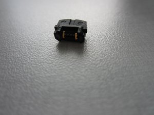

It is extremely hard to fix anything with this speakers, Plantronics service says it is not repairable, but... I can trot out that I have replaced one speaker from broken one my (green) with successful
below picture how it looks like - very tiny :)
May I know the procedure for opening it?
Hi, i wish you can explain how disassemble the earbud I order to repair it. A video is much appreciated. Thanks

the power button is shown.
crwdns2889612:0crwdne2889612:0 -1
whats the procedure in attaching can you provide one please
Hi, i also opened it up, but i cant reattach it. How did u do it
Do you know what type of battery they have?
