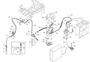

my machine leaks underneath, I can't find where the leak is coming from. I have cleaned it through and through, still leaks.
Today, it just shut down. Would not come on.
Renice Siefer this could be a daunting task, but the only way to find out is by taking it apart. Any of the small tubing or o-rings could be the reason for that. Here is a diagram of those tubing do give you an idea.

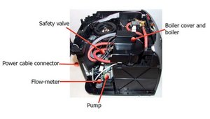

Check this video for a bit more information and another image to show you some of the tubing
and the disassembly of the outer shell

  1. Lastly, but least likely, it could be coming from one of the major internal assemblies, the pump, the boiler, the wand selector, the turbine, or any of the clamps inside the machine. In any case, if it’s one of those, you’d better send it to a service center to let them diagnose what’s wrong.
