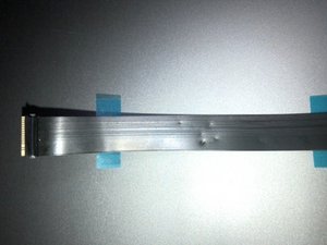

My problem was that dust/grit gets into the computer over the years and the cable is sandwiched between the outer case and the battery. Any flex in the outer case will crush the grit into the cable and cause dimples, eventually breaking one of the lines in the cable. See picture.
Thanks to ifixit for getting me going again!
