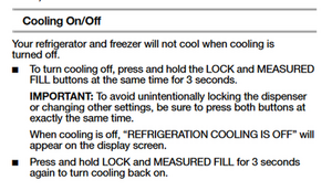

I recently had this happen on my parents fridge! It was a setting in that weird little touch screen that they have. I accidentally bumped up against it and it stopped cooling. After tons of searching for the manual I found one here: http://www.kitchenaid.com/digitalassets/... . Look on page 5 of this manual for the operation of the touch screen. In the touch screen controls there is a way to turn on and off the cooling. I don't know if this is the same problem you are having but I hope this helps!!

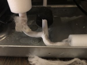

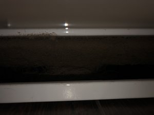

Same problem (( milk going bad refrigerator not cold )) looked and the coils on front under doors completely obstructed with lint dust hair… vacuum and removed back cover Freon lines all frozen , after about 15 min everything appears to be back to normal

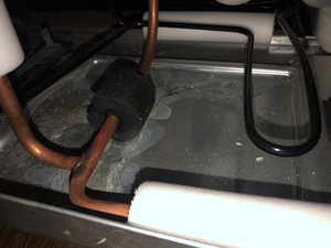

There is a big model list more recently added as of this posting, manufactured under Whirlpool Brands, that you can find on top-class actions that have a combination of problems from design, manufacturing - parts. I have model # WRX986SIHZ00 French door "dual evaporators" RC not cooling. FC works perfectly. The first place to "START" is the 3-way refrigerant solenoid valve and install a new receiver dryer simultaneously. This 3way valve is part of the sealed refrigerant system. Externally, the solenoid valve slides onto the refrigerant valve that magnetically turns the internal refrigerant valve either to FC or RC, so the refrigerant is directed to each individual evaporator compartment. The internal valve is defective and getting stuck in the wrong position. Currently, there is a back order on a new solenoid and refrigerant valve design. This combination can also cause "electric control boards" to become defective and have to be remanufactured. The manufacturing defrosts defect causes will be no ice cube production, warm in either FC, RC, or both. Ice build-up on RC evaporator middle drawer pushing out from ice build-up etc.
Im definetly getting no ice cubes being made now. have had issues since the year i bought, how hard is it to replace that refrigerant valve and receiver dryer? Is there a good site to order this? thanks.
@oilersman without the proper tools and knowledge do not attempt to do this yourself, please. You have to recover the refrigerant, use an oxy acetylene torch to braze in new components, then pressure test to make sure you're good using dry nitrogen, then pull a vacuum on the system. THEN you can recharge the system. You'll have to add some because you will lose a little from recovery. And these systems don't hold alot so an ounce or two missing will cause serious performance issues. The new charge has to be weighed in. Plus, most smaller systems do not have ports built in, so some will have to be added to put gauges on it.
