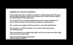

Here is a link to the User guide download for your mixer. In the guide it states that in the USA there is a 5 year warranty on the mixer. Check to see if your warranty period is still valid and if so make a warranty claim for a replacement.
http://www.searspartsdirect.com/partsdir...
