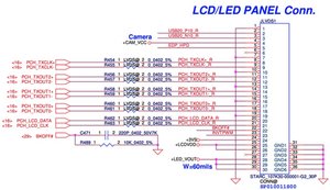

Screen connector wiring diagram
I am looking for a pinout for the connector on a acer c7 chromebook. I am also wondering if the screen can use pure rgb inputs. I am building an arcade cabinet for my car and the screen would be perfect but I am unsure if it will work.
Chromebook C710's screen interface is single channel LVDS. I grabbed this graphic from schematic which jayeff found.
