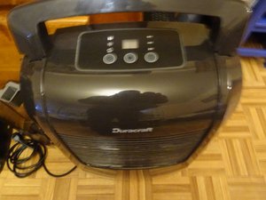

Duracraft DD-TEC10NE, after pressing power button display show PI ( P1) message that I can not clear to make it work. Any ideas ?

dulebu, the P1 error message means that the temperature in the room is too low. The temperature should be no less than 18 degrees celsius or the humidity in the room should be below 30%..

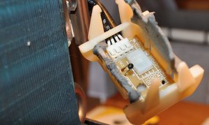

Hydro-Stat-Modul:
http://www.fotos-hochladen.net/uploads/w...

To repair the p1 error you have to replace the Hydro-Stat-Modul.
I do that and it works fine for me. Also you could only replace the hydro sensor on the old plate.

The little black component on the Hydro-Stat module is a temperature sensor used for the hygro measurement (combination of temperature and humidity to measure relative humidity)

The lead of the Thermistor on the Hydro-Stat-Modul of my Duracraft DD-TEC10NE has been corroded to the point that it didn’t made contact anymore. Please see the following picture:
I cut away the corroded part of the Thermistor leads and put it back in. Now it is fixed and seems to be working just fine again.

Same issue, unfortunately the thermistor in my case was so badly corroded, that I was unable to solder back in. The humidity sensor (next to it) also showed values in the many 10s of MΩ range instead of the kΩ range.
None of the component has any indication of range.
In the end, I bypassed both components by a regular 10kΩ resistor until I can get some replacement part, this way it works (but lacking the safety features + settable humidity setting).

J’ai eu le même problème, je l’ai résolu en refaisant toutes les soudures du module capteur y compris celles du connecteur (c’était d’ailleurs celles la qui étaient mauvaises), le capteur thermique est NTC valeur à 20° environ 500 ohms et le capteur d’humidité semble être un modèle capacitif (je ne suis pas vraiment sure)
