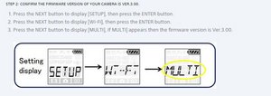

Hi, Have you tried a different card? Do you get a different message when you remove the card and start the camera? You could also try updating/reinstalling the firmware https://www.sony.co.uk/support/en/conten...
after update it look like working.. but i have still problem with ideo mood..
after updated i entered the wif/multi and then pressed enter but it is writing pre/await after that nothing happened so i pressed enter and it says fail..
so should i wait little more or?
Do not understand what you mean by wif/multi? What are you trying to do?
