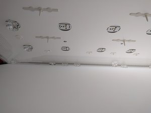

i have lg 32lb5610 LED Tv purchased before 19 months , today suddenly i can see 2 while light spots about 2 inch round shape, . please tell me what could be the issue and fix for this.

I had the same problem and it's really simple to solve! The 16 dots you're seeing is the light from the LED backlight. In front of the backlight there's a plastic cylinder very casually glued over it (thanks LG) that diffuses the light, when that drops you see the LED light directly projected onto the screen which causes the white spots.
You just have to dismantle it (not too hard), buy some glue and paste those plastic pieces back.

Thanks for your input. this is same as the problem you said and solved it. i have attached the cylinder picture. i have applied little glue on the 3 supporting dots and stick it.https://goo.gl/photos/ZcPD8B8dKQbaF8SVA
