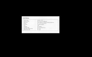

Here are the electrical specifications for your scooter.
It has a generator* to provide electrical power to the motor as well as charge the battery. The specifications state that is has a 6V 2AH battery (2AH =7200 Coulombs, that's what the 7.2kC means).

If you can't get the manual for the correct year check what voltage value is stamped on the brake light or headlight bulbs.
This will tell you what the battery voltage is.
It should also be written on the battery. If it is no longer there, for a 1983 model it is a 6V 2AH battery
This link confirms that your year model also has a 6V 2AH battery.
