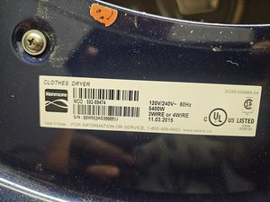

Hi @tania65265,
I can only suggest that you contact this parts supplier and ask them if they have parts for the dryer and a user manual and also if they may know what's wrong. The contact number is at the top right of the page linked.
Your model is a Samsung DC68-02688A-04 model made for Kenmore where it has the number of 592-89474.
There's no other information online regarding this model or at least none that I can find

My model literally says 592-89474 as I have attached the dryer sticker.
Does the same thing, cooling light stays on but no heat no matter what setting I select.
