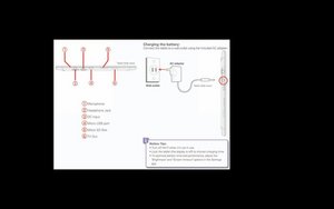

I can only charge this computer twice
I can only charge this computer twice, in a 24 hour period. That's how long it takes to recharge.
This doesn't make sense. There is no port left or right. They are all in a row. The mini instructions shows where the USB port is & comes with a too short cord to plug into it. It does charge, but it takes hours to reach 100%. Hense the twice recharging in a 24hr. period.
Hi armetha1,
The charging port (#3 in the image) should be used to charge the battery as it allows you to connect the AC adapter, which should supply 5VDC 1A (1000mA) to charge the battery. The power output of the adapter should be printed on the adapter.
If the AC adapter cord which plugs into the tablet is too short to comfortably site the tablet for charging near a power outlet, plug the AC adapter into an extension cord which is then plugged into the AC power outlet to give you more flexabilty about where to place the tablet when charging.
Try turning the tablet off when you want to charge it, as this will speed up the charging time.
Trying to charge the tablet via the micro USB port using a USB cable attached to a PC will take twice as long because a PC only supplies 5VDC 0.5A (500mA)
