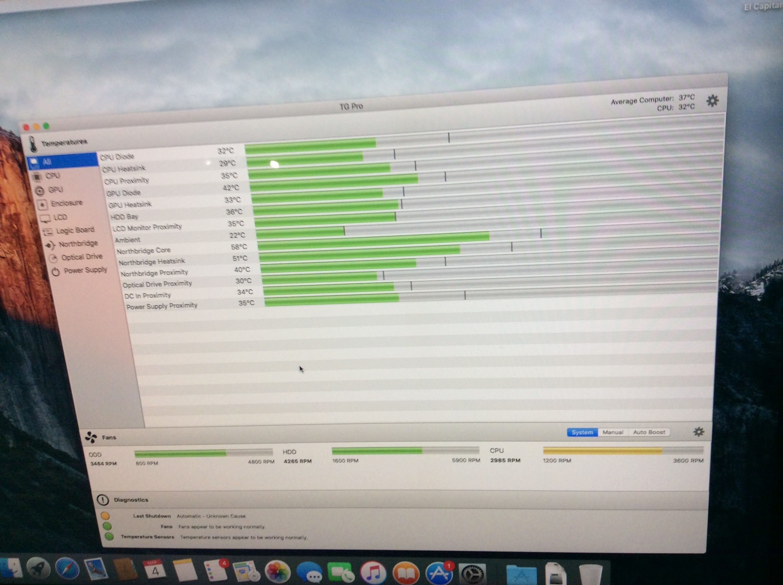

Install the app I pointed you to in my first answer TG Pro
Most likely you have a temp issue. Have you opened the system up and cleaned it yet? I would start there.
I would also recommend you install a sensor monitoring app like this one: TG Pro. If you buy the full version it will log the fans & temps upto the point of the system shutting down. So you can see if that is the issue. Paste a screen shot of the TG Pro console so we can see as well.

hi, thanks for the reply, did what you said, opened itn not dusty or dirty, installed tg pro, last shutdown...automatic unknown cause, temperatures sensors seem to be working normally, fans normal also

Do what Dan says first. The no dust at all comment bothers me. These things are vacuum cleaners and suck dirt in. The shut down may be caused by automatic shut down from high temperatures caused by a failed fan or temperature sensor not kicking the fans on. There are generally three fans, a CPU an behind the logic board, an optical bay fan on the right and a general fan on the lower left side. See if you can determine if all are kicking on.
