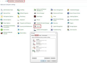

Hi @burke020,
What control panel are you looking at?
To get to Win 10 Control Panel, type Control panel in the search box on the left side of the desktop screen and then click on the Control panel app link that appears.
Just verifying that when you click on Control panel > Sound that it appears similar to the image below. The audio controller info will most probably be different and no line input options etc but it should have a microphone listed.
If not check in Device Manager > Sound, video and game controllers and ensure that the sound controller is installed properly. No red cross or yellow exclamation mark shown beside it.
(click on image to enlarge for better viewing)
